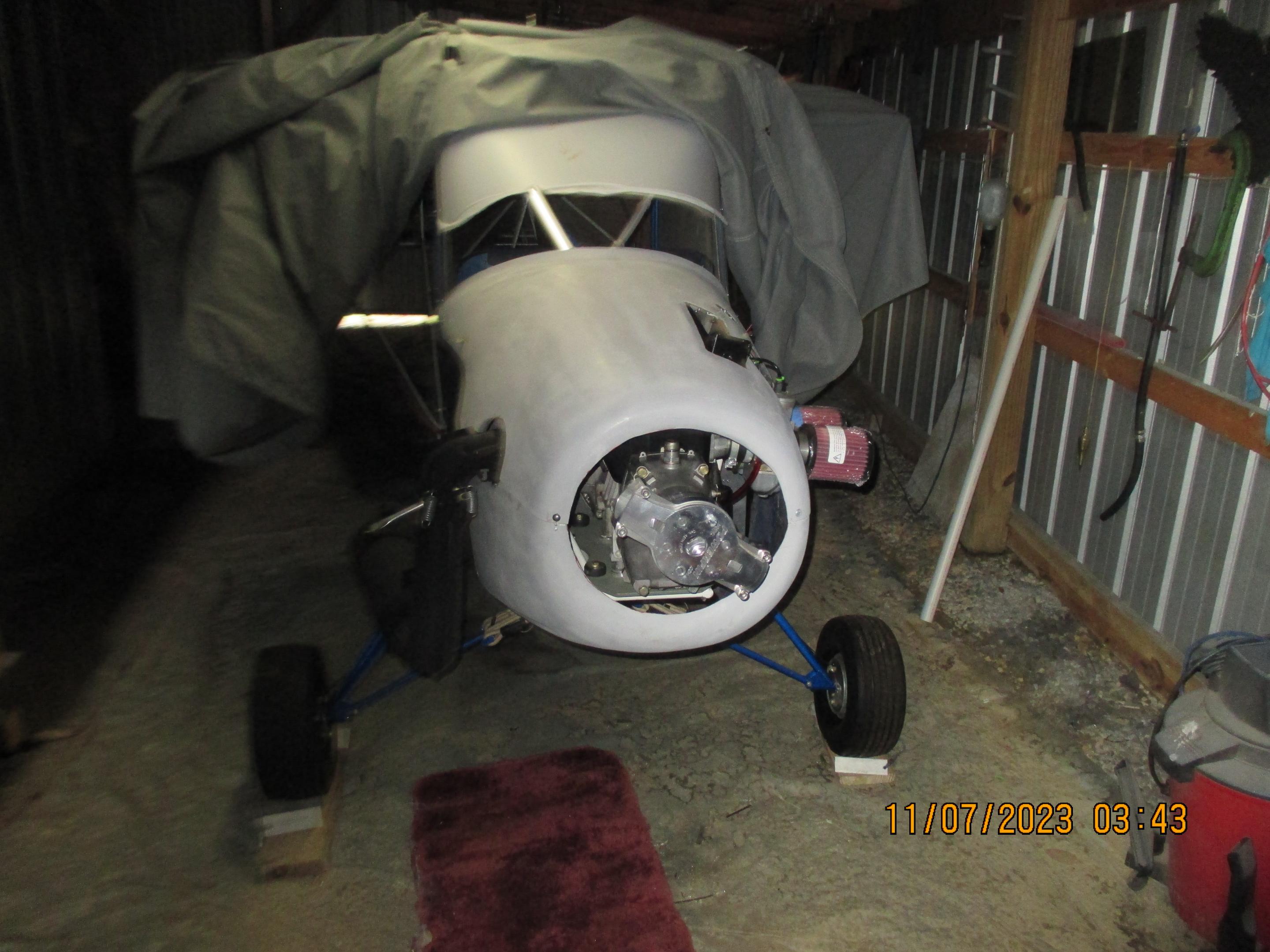

Not going to paint cowling till everything dialed in.

Definitely looks like a snug fit!

LA F2 Flyer wrote: Tue Nov 07, 2023 6:33 pm Definitely looks like a snug fit!
I really like that smooth cowl.
Todd

That cowl was about 70% homemade. I had a few pieces left from the Polini modified cowl so I made most of it. Still have a small amount left to do to it.

Mountain Cat wrote: Tue Nov 07, 2023 8:27 pm That cowl was about 70% homemade. I had a few pieces left from the Polini modified cowl so I made most of it. Still have a small amount left to do to it.
That's awesome. I've gone through many imaginary cowl builds in my head, all depending on which engine I finally go for. More consultation with Chris and Scott will be needed before I make my final choice for what will be under the cowl.
If I go with a two stroke, I'm leaning towards the Hirth F23. I've heard very little bad about it, and what I have heard has for the most part hints of user caused issues. I think you also have recommended the F23 several times from personal experience?
If I go four stroke, which is what I'm really leaning towards is the Thump Air Scott has built and he and Chris are testing. The 35hp version is available now but Scott has manufactured a billet head and other parts to bring the HP into the low to mid 40hp range. TBO is still at 300 hours but Scott mentioned (if I recall correctly, which is questionable with me....getting old and possible wishful thinking 🤔) that the TBO is at 300 for safety only. TBO may go up as testing results provide more positive results.
I like both engines a lot. For know, designs in my head is all I can do until I have the real McCoy in front of me. 🥺
I'm not a fan of the bump design, so looking for other possibilities. You've got a real nice smooth design.
