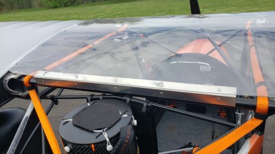

Badland F3 Parachute (Comelli) installation
Post by broughtonkicks »
Greetings All!
Things have been rather busy here and I have been negligent in updating everyone on the additions/changes to my F3 Speed.

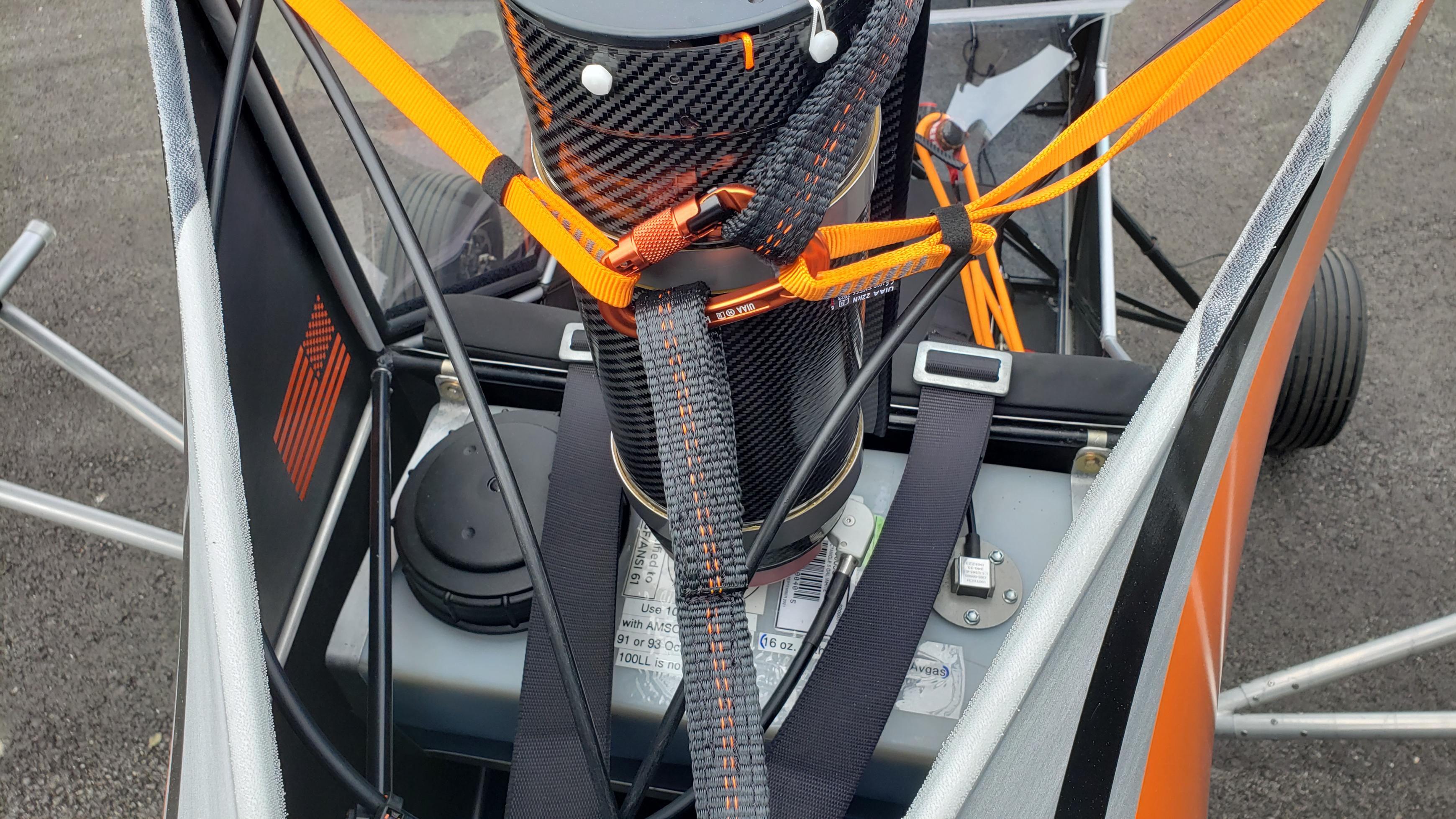

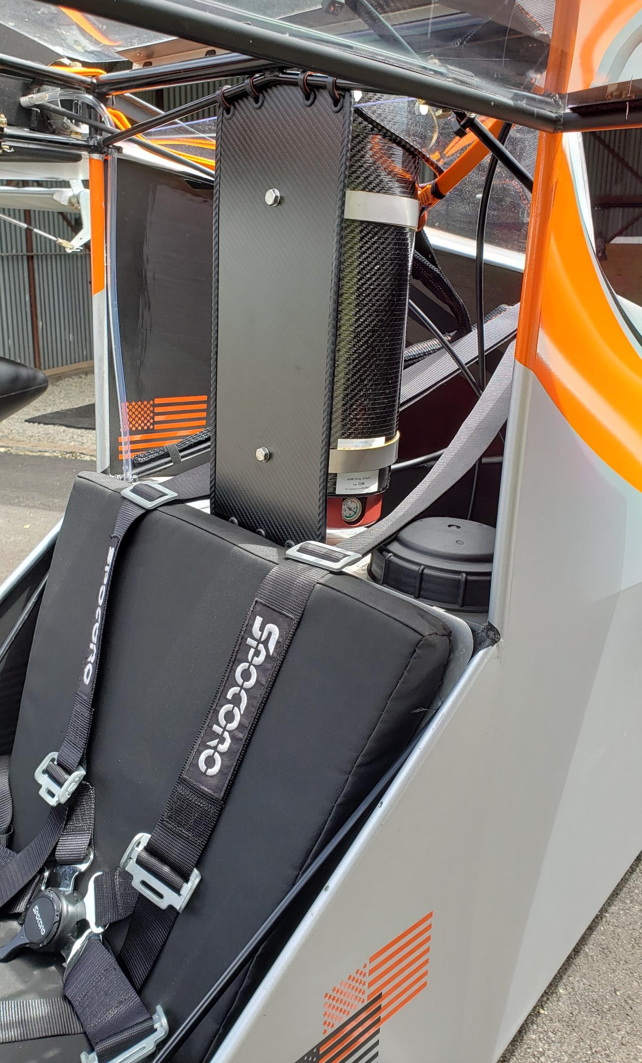

I had received some messages from a couple of “concerned” individuals about my doors, and "being over Part 103 weight" (wanting to debate if doors count as being removable, blah, blah, blah!). So, rather than risk someone potentially making phone calls to "the authorities" on me, I installed a Comelli Parachute (Cylindrocone KOB PD45) with carbon fiber cylinder. It weighs just over 11 lbs., compared to the BRS that weighs 22 lbs (and Magnum I think is 15 lbs.).
My Comelli Parachute has a 6 ft Bridal and a 6 ft Activation Cable.

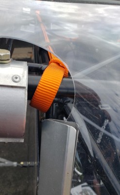

Working from the same BRS mock-up image that Tom posted; I added 2 additional nylon Climbing Slings (16mm x 4 ft. Rated at 4,950 lbs each) that are looped around the header bars near the front spars, so as to have 3 points of attachment. The Larger Bridal from Comelli is attached at the fuselage gusset where the shoulder harness bracket is located. The 3 bridals are connected to the chute with a 5,621 lb rated Locking Climbing Carabiner. The bridals are held in place along the frame by light velcro strips so that they can pull apart if the chute is activated. The Activation Cable is secured to the cockpit frame with Grip Lock Ties.
The parachute is activated pneumatically (rather than ballistic or nitroglycerin), so it is lighter than comparable chutes. Comelli chutes come with 2 mounting straps/brackets that I secured to a (~7" × 19") carbon fiber panel directly behind the seat (above the fuel tank). I drilled holes in the carbon fiber panel large enough to insert rubber grommets, that the 7 Grip Lock Ties (rated at 70 lbs each: but are tested at >140 lbs = 980 lbs.) pass through to secure the panel to the fuselage behind the seat.
I trimmed the carbon fiber panel with “faux carbon fiber” auto door edge trim.
My intent of installing the parachute is more in-line with the appearance of complying with FAR Part 103 weight guidelines rather than with any concerns of needing to deploy it in the future (however, it won’t hurt to have it if ever needed!).
So, since I now have the additional weight allowance; I also installed a couple of (REMOVABLE -LOL) Cargo Pods (only weigh 2.5 lbs each) for my bucket list cross-country trip!
I also made a quasi mini "turtle-deck" from Lexan to cover the back “cargo” opening in the event of rain on my travels! The Lexan allows for inspection of the parachute, bridle, harness attachment, etc. It is secured to the frame with 3M “low profile Dual Lock”, making it easy to remove for inspection (and to pop off should the parachute be deployed). The Lexan turtle-deck is trimmed along the sides with transparent auto edge trim, and around the parachute cut-out with the same “faux carbon fiber” edge trim.
The images posted should help with some clarification.
I hope this helps others who may be considering the same options.
~Barry

Beautiful installation Barry. It looks fantastic. (Which means, at the end of the day, that it matches the rest of the plane.)
-Peer

Looks great! I have a centered fuel cap but will see how it fits when it gets here. Thanks for all the info and pictures!!
