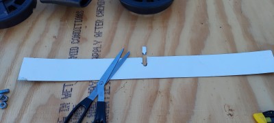

My biggest problem with my tire assembly was trying to prevent the tube from getting pinched in the gap where the two wheel halves meet up. This is how my tube got ruined on my previous attempts. There is just no room there to get your fingers to help tuck the tube out of the way. The white strip in the picture is my "Pinch Eliminator" Its just a strip of thick posterboard about 1 3/4 inches wide and long enough to wrap around the inside the perimeter of the wheel. Allow some extra length so there will be an inch or two of overlap as you wrap the strip around the perimeter of the wheel half.
Notice I cut a notch in the strip to allow the valve stem clearance.

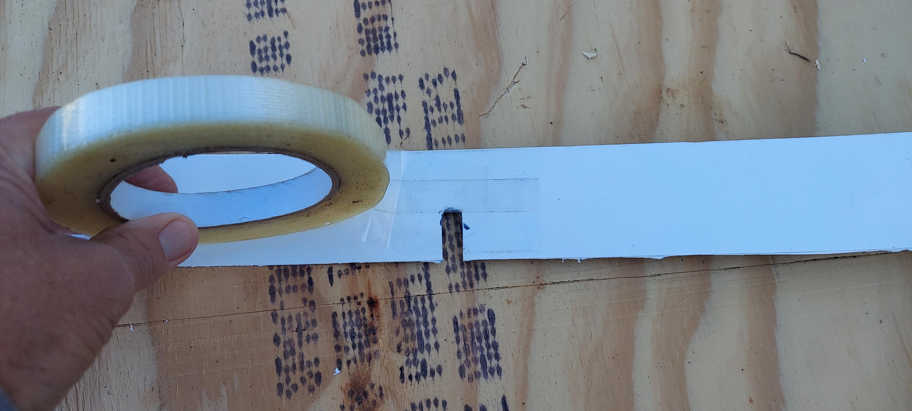

I taped the area around the valve stem cutout so the paper won't tear as a manipulate it onto the wheel. I taped both sides with heavy duty strapping tape I had laying around.
I taped the strip together so it wrapped all the way around the wheel. Note, my posterboard was white on one side and black on the other.

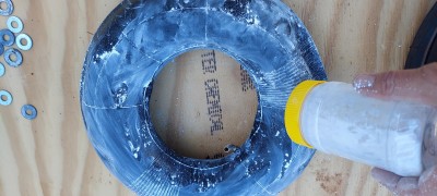

I put some talc (baby powder) on the tube and inside of the tire. (You might be able to skip this step if you can't find any talc) I took the valve core out of the tube and inflated the tube to give it some shape since it was all flat from how it was packed for shipping. Stuff the tube into the tire and give it a blast of air to get it to conform to the shape of the tire.

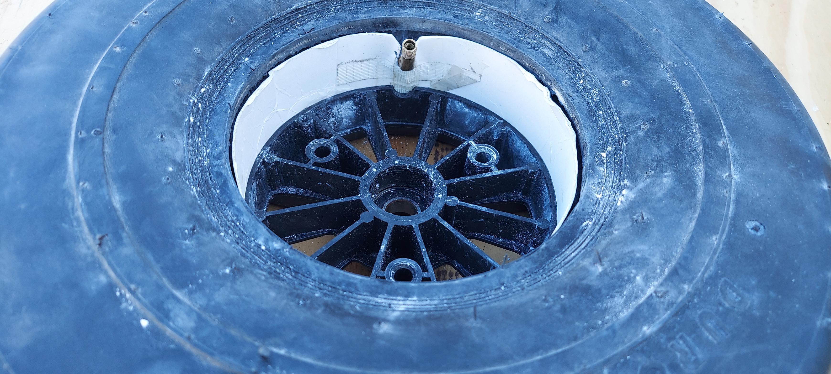

Slide the tire/tube combo onto one wheel half, then slide the paper strip into the tire and get it to slide over the plastic wheel.
This is the hardest part of the process as the bead of the tire gets in the way. Don't be afraid to bend or crease the posterboard to get it to slide over the wheel half. BE SURE AND LINE UP THE SLOT YOU CUT FOR THE VALVE STEM TO THE ONE ON THE WHEEL.
You need to get about 1/2 the posterboard onto the wheel, the rest of the posterboard will be for the other wheel half. I used the lip of the bead to help push the posterboard down to get it to uniformly slide onto the wheel half. The poster board strip should be about 50/50 on the wheel.
