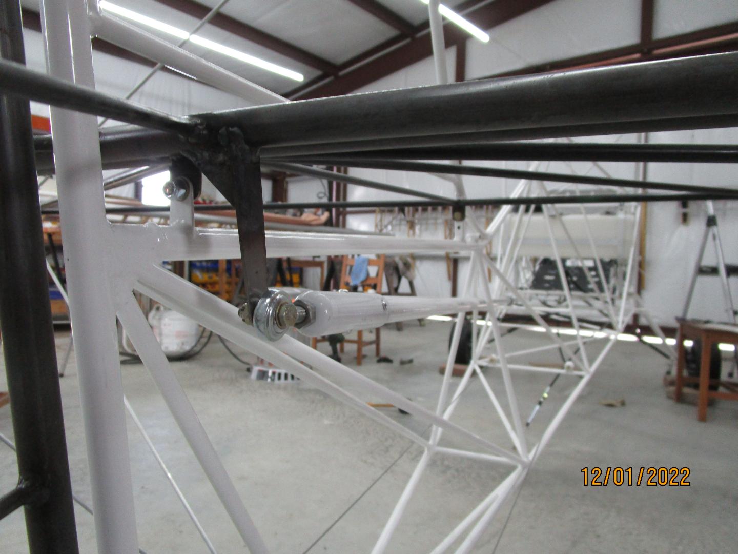

I mounted the firewall to the fuselage today and the two piece welded engine mount from Chris. I think I have a problem ... the Polini aluminum mounting ring only aligns with 4 of the 6 mounting positions. I fired off pictures to Chris this afternoon but haven't heard back as yet. I hope it is merely an alignment error on my part.
I have done a trial fit on most of the flight controls and had to bend the elevator push rod from the stick housing to the reverser arm. I also had to trim the nose bushing on the stick housing down considerably in order to have the stick centered for all the control arms attachments. More pictures tomorrow in the Build log.

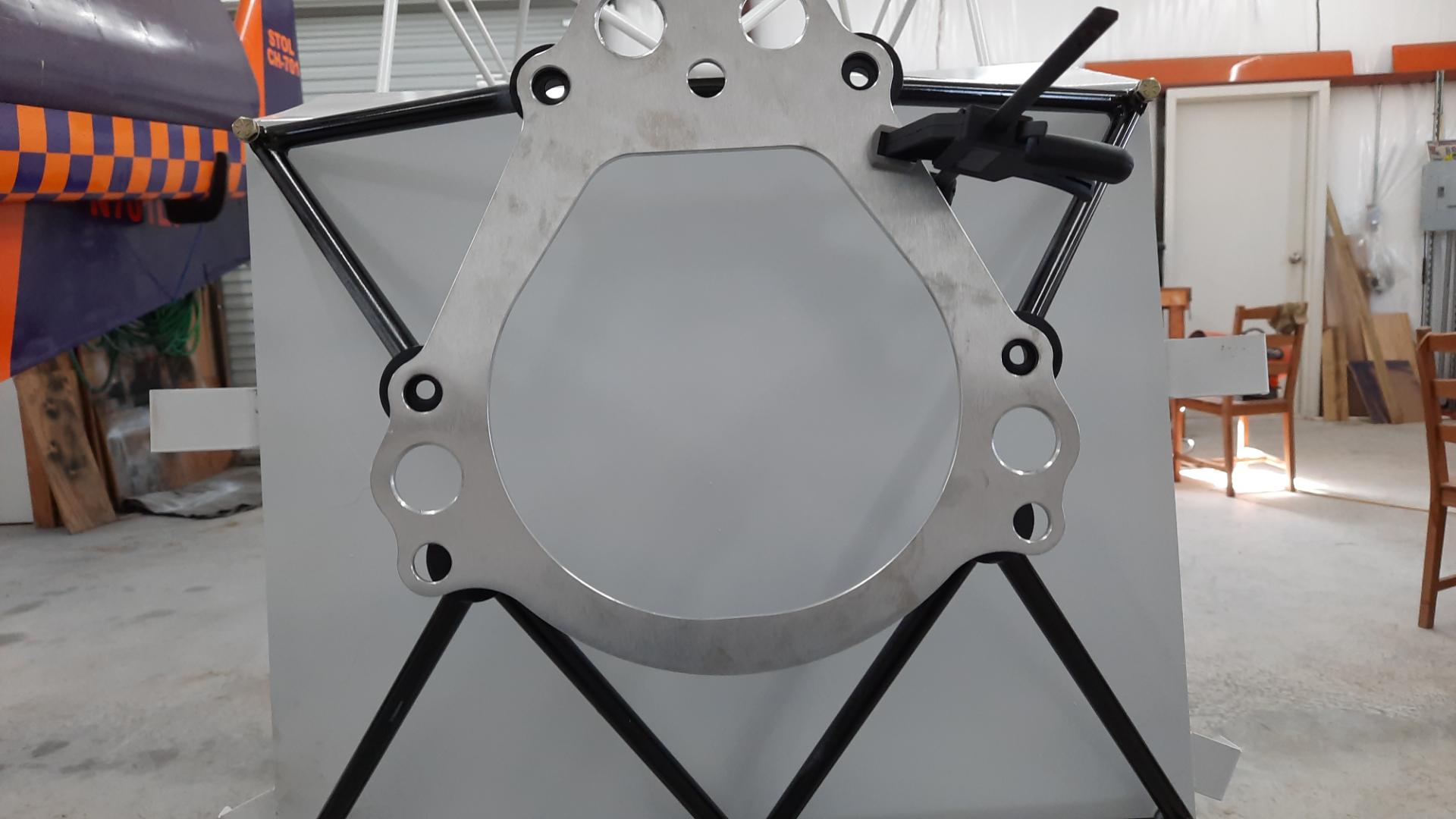

Chris took one look at the pix of the Polini mount ring positioned on his beautifully welded, 2-piece mount and said that it appears Polini has changed tge configuration of the mount ring. He's going to check and either get me an older version or fabricate one for me.
With the mount stumbling block, I spent the afternoon working on a template for the floor-boards. I took a lot of measurements and diagrammed-out a pattern in VISIO (my only drafting tool). I have some Hobby Lobby poster-board and will attempt a real pattern tomorrow (Sunday).

Re: Build Log Discussion - ksatter26
Sure enough, Chris has heard from Polini and we have the wrong mounting plate. He has the replacement and is sending it out today. I'll return the one I have to him.

Still waiting on my replacement Polini mount ring so no progress on mounting the 303. The engine comes in a nice welded tubular steel box frame so it is really ruggedized for shipping.

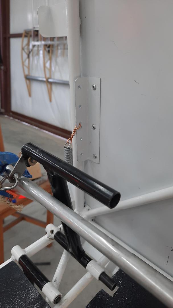

Chris says the tailwheel angle should be near 58.8 degrees mine is 56.9. He says that should be fine. I can slightly bend the rudder/tailwheel arms forward to gain a bit more than the 5.5" I have fir spring length. What I did was get to a good hardware store and got a pair of shorter springs with long hook ends which seem to work well

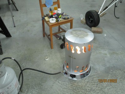

Not looking forward to the cold weather. The shop/hangar is not heated except for my rather small propane contractor's heater.
Replacement Polini Mount Plate Incorrect
The replacement mounting plate fixed the positioning of plate-to- engine mount holes BUT the shock mount holes were bored oversize. Chris has made the CAD fike fix and I expect a good one in a week or so.

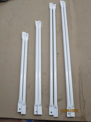

I got all the lift and jury strut parts off to the local powder coater. I expect those back next week as well.

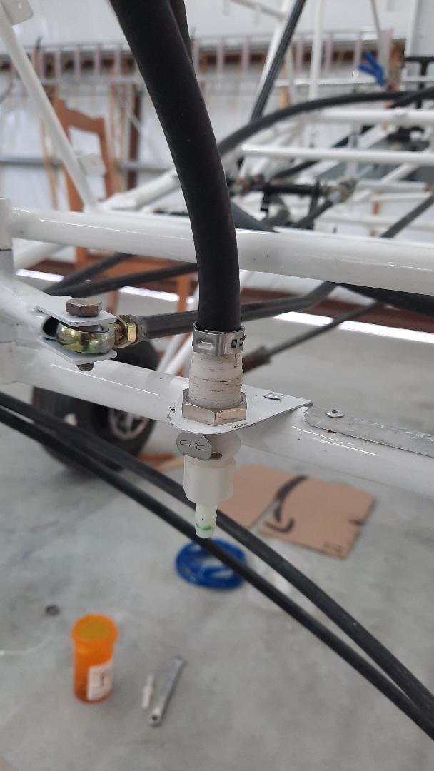

Started plumbing the fuel lines by installing a T-fitting from the tank. One path is almost straight down to a quick-disconnet fitting at the lower cross-member for draining the tank. Naturally the other runs to the engine. Trying to decide where to place the in-line fuel filter (probably on the engine side of the firewall) and the primer squeeze-bulb ( probably along the port-side of the cockpit just forward of the flap handle). Hope to post pictures later.

Control PedalSprings & Quick Release Drain Fitting
The bar positions the rudder Pedal in the neutral position as is the rudder also clamped in the neutral position for setting the control cable length. The L-angle is pop-riveted to the firewall and allows 5 locations for attaching the rudder and brake return springs.
The fuel tank drain quick disconnect is a nylon bulkhead fitting mounted on a bracket pop-riveted to the cross-member behind the seat. The lower portion of the valved fitting will have a length of 1/4" flexible fuel line attached and is inserted into the fitting only to drain the tank.
- Posts: 631
Re: Control PedalSprings & Quick Release Drain Fitting
I like the drain quick-disconnect, as I haven't yet included one in my fuel delivery system. Does the tank sit back far enough not to interfere with the hose or bracket? And I'd love to see your fuel line routing when you are at that point.

I'll get better pix of the drain/disconnect ( nylon from US Plastics). I'm re-thinking the fuel line routing to the starboard side. The fuel level transducer wires are on that side.

Powder Coating Strut Parts
As requested ...
Elevator Push Rod coated and installed ...
Lift strut and flaperon mount parts (done, but not pictured are the jury struts)...
New 80K BTU shop heater ... now I just need some gap seals on the hangar door-frame.

Looking really nice Kurt. I really like the way the powder coat came out. You must like it too. Just in time on that heater too. Seems we'll have a wet cold week coming up. I just put on some rubber/flexible seals on my garage door (one for each side), and it does make a big difference. I also took a look at your fuel routing and control connections. They are all really impressive. Do you have any concern over any added weight or is there any with using turnbuckles?

Trial mount if the engine to locate the positioning of components on the firewall: starter relay, fuel pump, fuel line/ filter, pass-through for throttle,, CHT, AND EGT cables.

Pretty nice getting that correct engine mount and getting it in place. Looks sharp.
